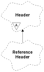

Figure 23. ImqReferenceHeader class
A Booch class diagram showing the ImqReferenceHeader class and its parent class, ImqHeader.
