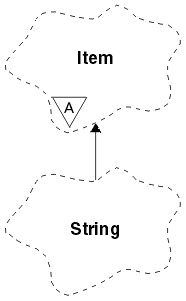

Figure 24. ImqString class
A Booch class diagram showing the ImqString class and its parent class, ImqItem.
