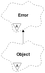

ImqObject
Figure 18. ImqObject class
A Booch class diagram showing the ImqObject class and its parent class, ImqError.
This class is abstract. When an object of this class is destroyed, it is automatically closed, and its ImqQueueManager connection severed. This class relates to the MQI calls listed in Table 19.
