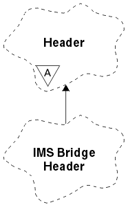

Figure 13. ImqIMSBridgeHeader class
A Booch class diagram showing the ImqIMSBridgeHeader class and its parent class, ImqHeader.
This class encapsulates specific features of the MQIIH data structure (see Table 14). Objects of this class are used by applications that send messages to the IMS bridge through WebSphere MQ for z/OS.
