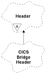

Figure 7. ImqCICSBridgeHeader class
A Booch class diagram showing the ImqCICSBridgeHeader class and its parent class, ImqHeader.
This class encapsulates specific features of the MQCIH data structure (see Table 9). Objects of this class are used by applications that send messages to the CICS bridge through WebSphere MQ for z/OS.
