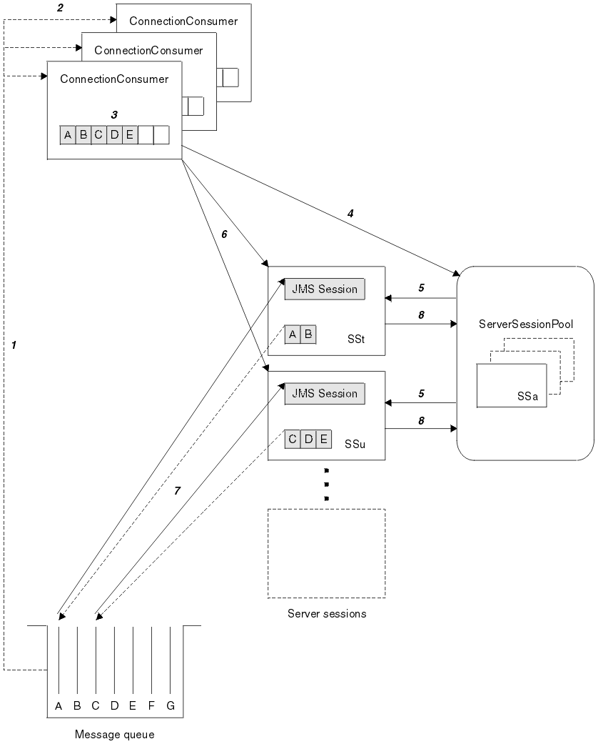

Figure 6 summarizes the principles of ServerSessionPool and ServerSession functionality.
Figure 6. ServerSessionPool and ServerSession functionality
