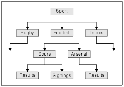

Topic names in WebSphere MQ JMS are arranged in a tree-like hierarchy, an example of which is shown in Figure 3.
Figure 3. WebSphere MQ classes for Java Message Service topic name hierarchy
A diagram of part of a hierarchy of topic names, referenced in examples in the following text.  The hierarchy shown has four levels:   At the top level, the single topic Sport. At the second level, the three topics Rugby, Football, and Tennis.  For lower levels, the diagram concentrates on Football while indicating that there are likely to be other sub-topics dependent on Rugby and Tennis. At the third level, there are two topics, Spurs and Arsenal. At the lowest level, there are three topics.  The sub-topic Results is shown twice, once under both Spurs and Arsenal. The sub-topic Signings is shown under Spurs only.
In a topic name, levels in the tree are separated by the "/" character. This means that the "Signings" node in Figure 3 is identified by the topic name:
Sport/Football/Spurs/Signings
