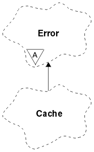

Figure 5. ImqCache class
A Booch class diagram showing the ImqCache class and its parent class, ImqError.
Use this class to hold or marshal data in memory. The user can nominate a buffer of memory of fixed size, or the system can provide a flexible amount of memory automatically. This class relates to the MQI calls listed in Table 7.
Other relevant classes
ImqError (see ImqError).
